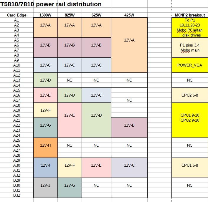

Hey windius on the discord just found this. Thought it was worth sharing on here. I would assume it works on the other precision models as well. At least the ones that take this smaller board.

so the board is a great idea but im cheep so after some digging im managed to get this thought i would share it here .
it explains where the rails are on the power supply.
