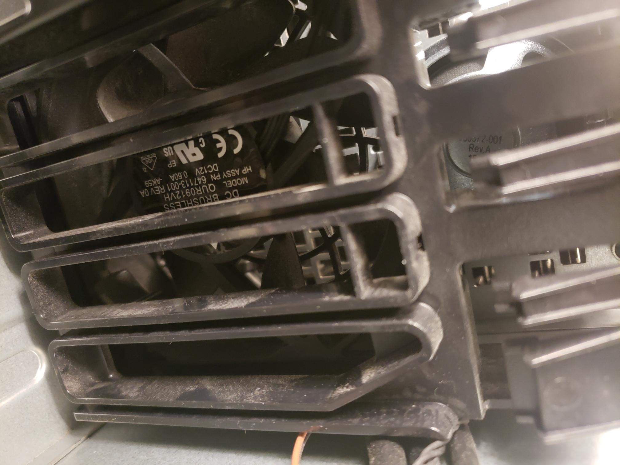

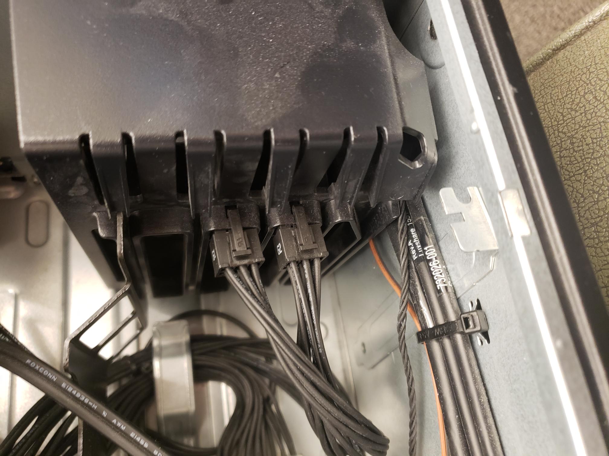

Good morning,
Okay...just got into my office and had another look at the GPU fan and it seems I messed up. Turns out the fan has two 6-pin sized sockets, but what they truly are is just storage sockets. There are no electrical connections on the backside. As I initially opened the case, I found one of the 6-pin connectors plugged into the socket...so I assumed it was used to run the fan. Pretty good "duh" moment on my part.
Adding some pics so you can see what I'm talking about.
Needless to say, all is good on my part now that I've managed to extract my head from my rear end... Thanks all!

Re: HP Z440 GPU Upgrade - Power Connector Issue
Sneaky sneaky lol. Ya so now you need even less parts. 1 6 to 8 pin adapter and your golden.
