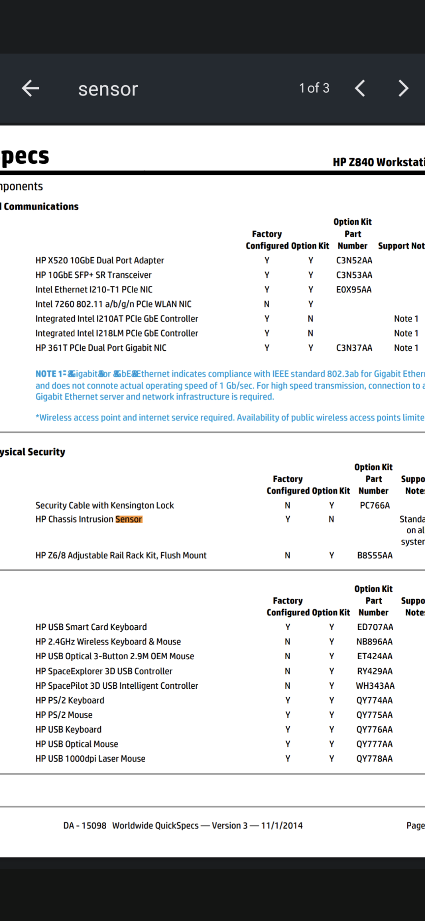

g0tht3ch wrote: Sat May 13, 2023 11:18 am This is referenced in the manual/BIOS - but I can't find a part number for it, or board connector. Has anyone seen/got one/know the part number?
I believe what the manual is talking about is just a cover switch. It should create a time stamped log in the bios every time you remove the cover.

I note that says "Factory Configured" and not an "Option Kit"
However this page (https://partsurfer.hp.com/partsurfer/?s ... xt=F5G73AV) shows P/N as being "638816-001" for a "Hood switch for lock sensor module" - but no comment on a lock sensor module?

It's going to be a part of the motherboard. Not a separate removable part.

Checking the doc you screenshotted, although it says "Factory Configured" it does also state (to the right) "Standard on all systems"....
(the Z4 also has similar)
Must be possible somehow :)
