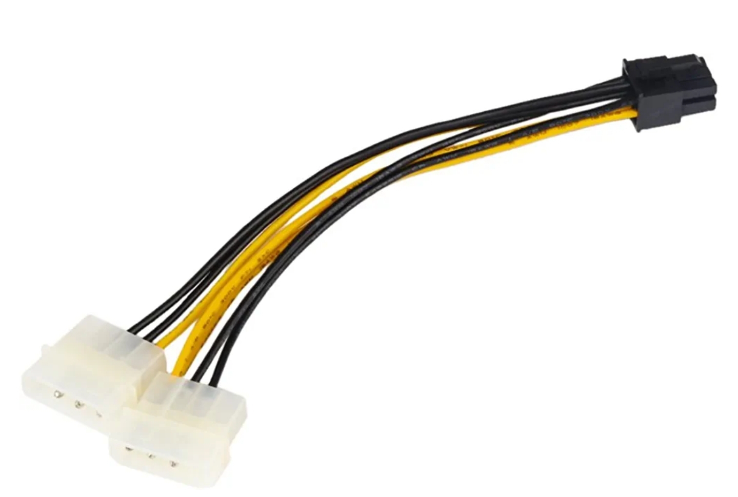

I've been looking for the harness with the (3) 6pin plugs and I can't find one. Has anyone thought or pull of the idea of buying the harness with only two plugs and de-pin one and use the harness to pin another to make the three plug harness? Or is everyone just using the 4 pin molex to 6 pin and a 2 6pin to 8 pin adapter?

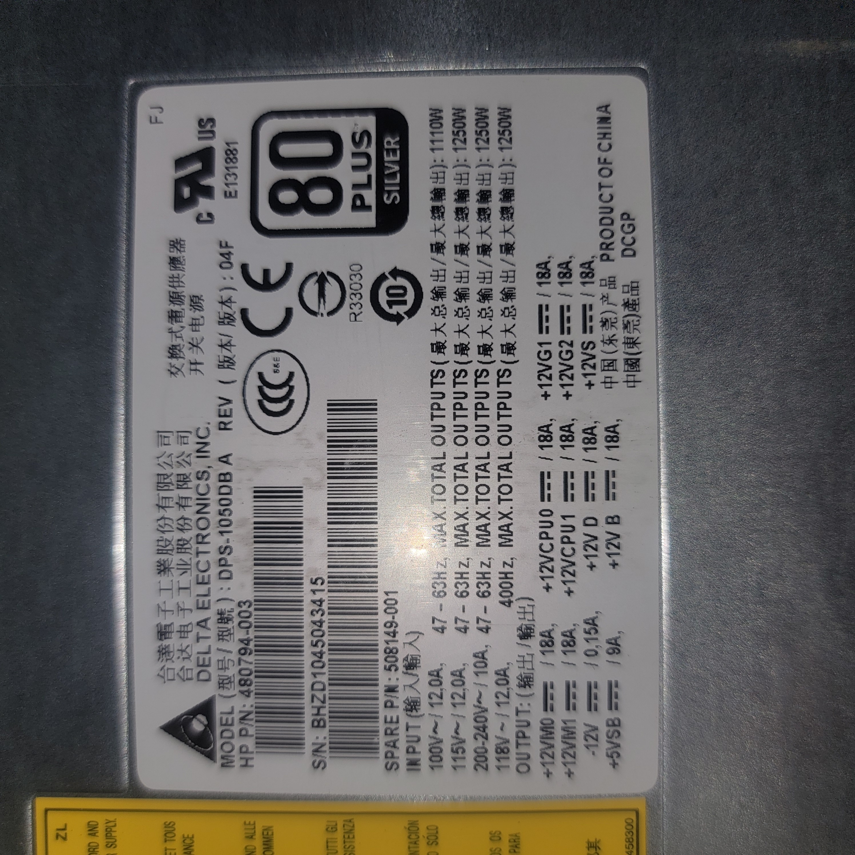

Which psu do you currently have? Could you post a photo of all the rails listed on it? There may or may not be an benefit to adding the additional harness if there isn't a separate rail to pull from.

I am running the 1100 watt psu.

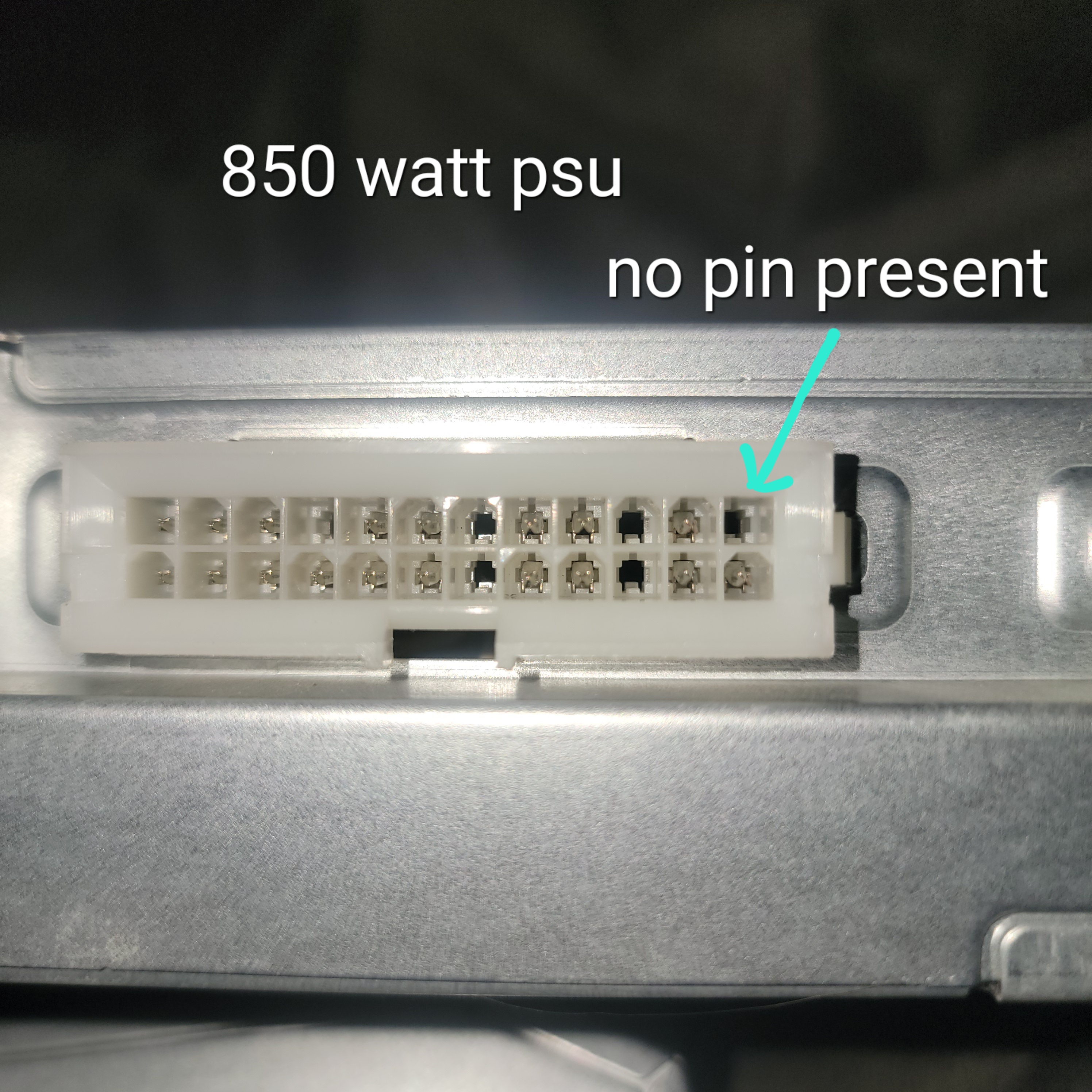

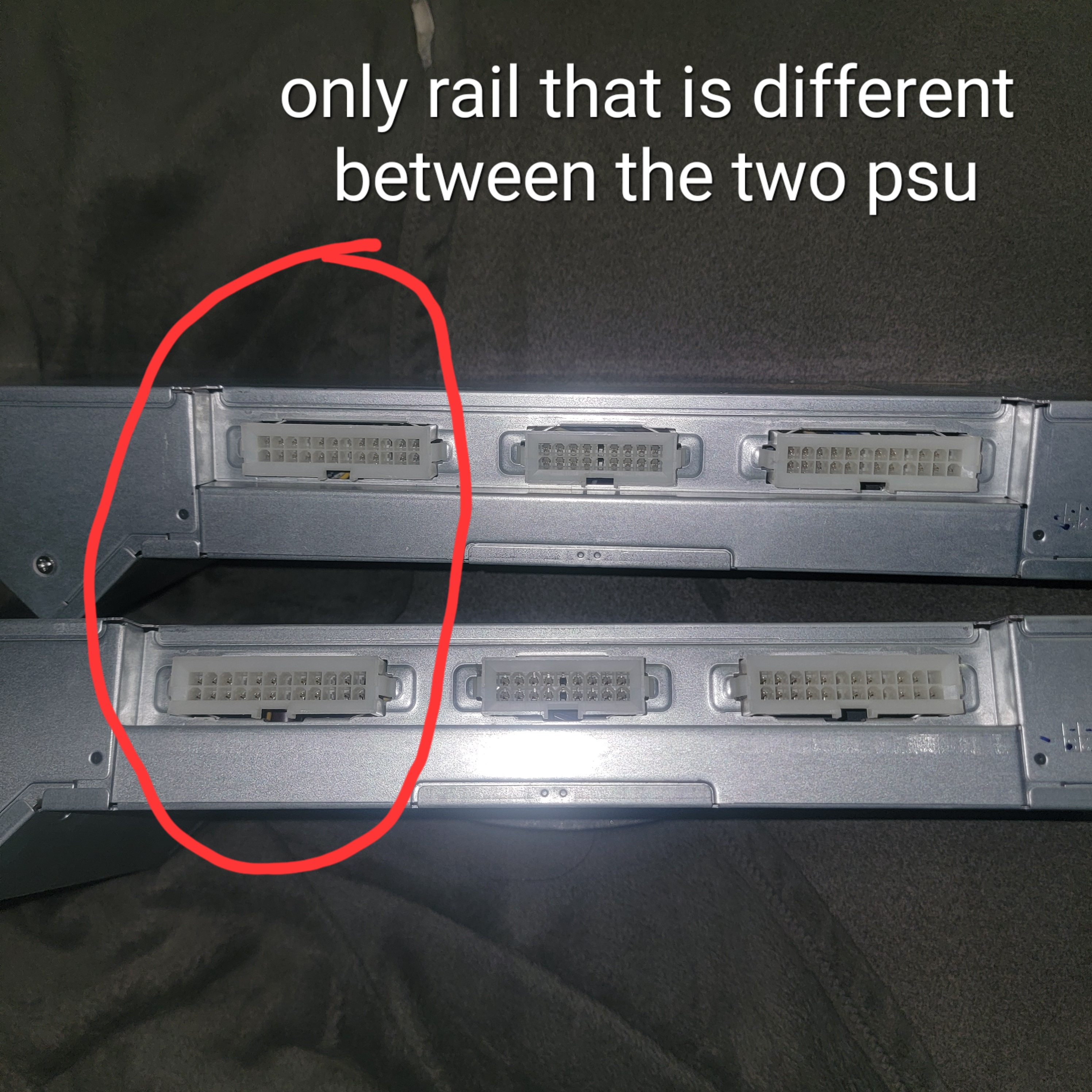

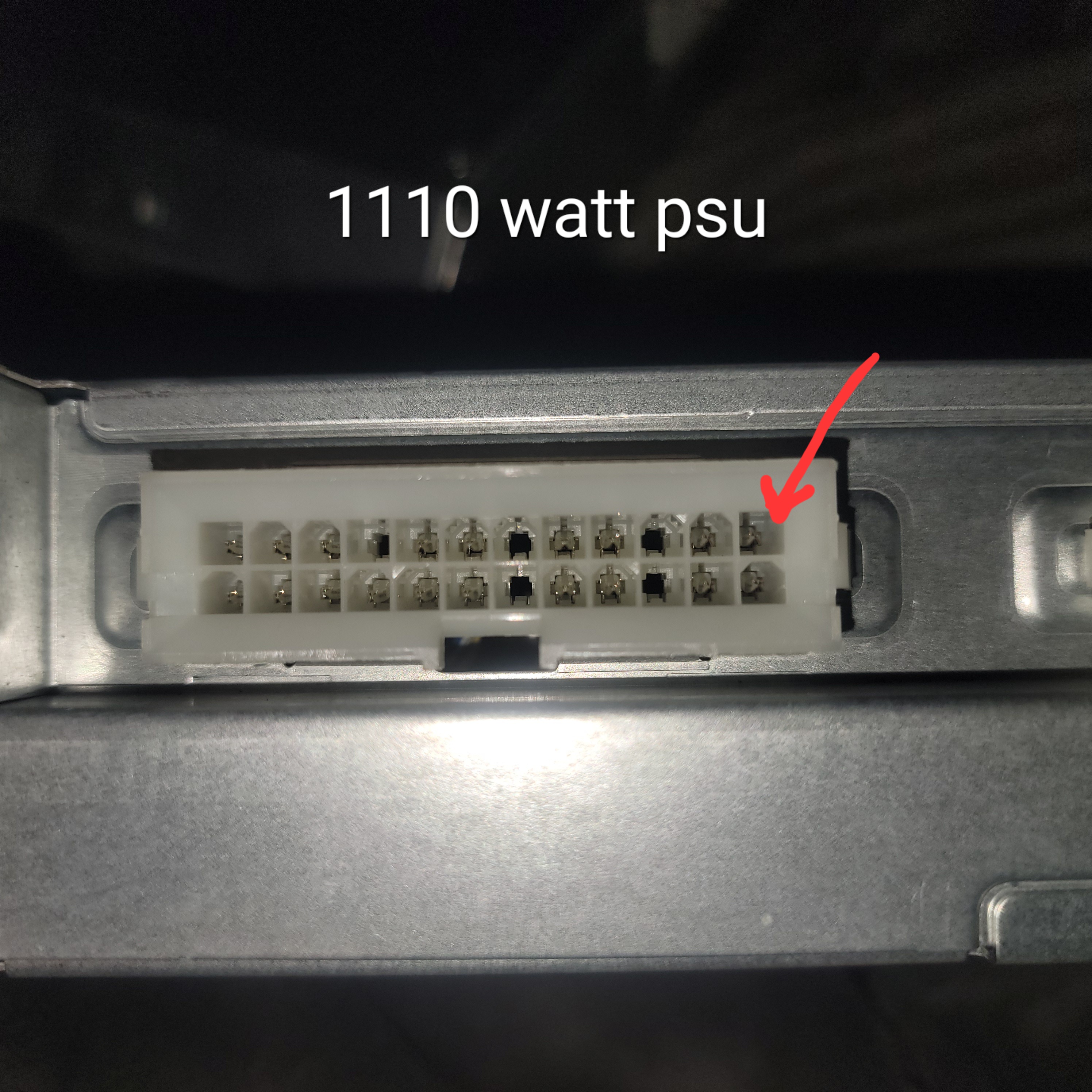

I am looking at my old 850 watt psu and comparing it to the 1110 watt psu and the only difference that I see in regards to the pins in the rails is that the 1110 watt psu has one additional pin vs the 850 watt psu.

Well what I wanted to get at on your psu is you have 2 18 amps rails for graphics. So if you have 2 or 3 connections coming out the available power is the same. I'm looking at 12vg1 and 12vg2. What card are you attempting to run that you need a third connection?

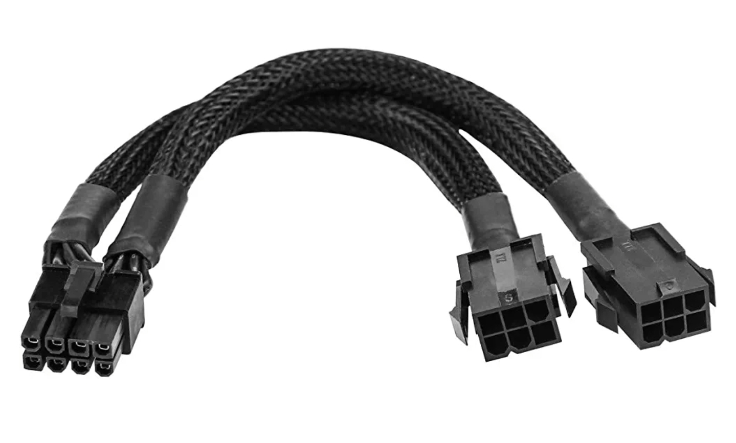

I'm trying to use a gtx 1080 ti which requires a 6 pin and 8 pin. I had initially asked if people were just running these instead.

Since it's confirmed you have 2 18 amp rails on that PSU you should be just fine using a 6 to 8 pin adapter.
